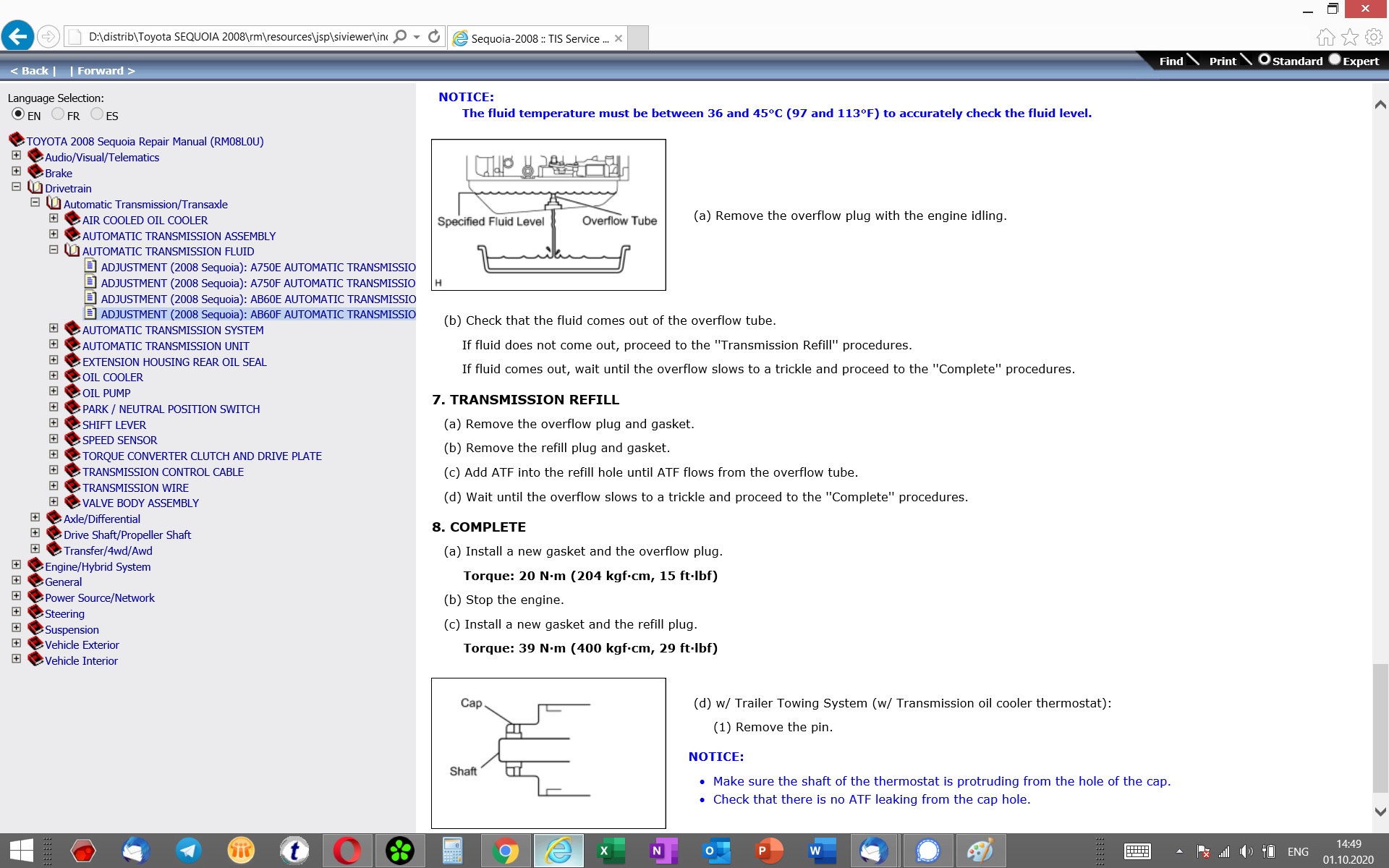

Всем доброго времени суток! Уровень масла в акпп проверяем при заведенном авто или же нет?

6. FLUID LEVEL CHECK
NOTICE:
The fluid temperature must be between 36 and 45°C (97 and 113°F) to accurately check the fluid level.
(a) Remove the overflow plug with the engine idling.
(b) Check that the fluid comes out of the overflow tube.
If fluid does not come out, proceed to the ''Transmission Refill'' procedures.
If fluid comes out, wait until the overflow slows to a trickle and proceed to the ''Complete'' procedures.
7. TRANSMISSION REFILL
(a) Remove the overflow plug and gasket.
(b) Remove the refill plug and gasket.
(c) Add ATF into the refill hole until ATF flows from the overflow tube.
(d) Wait until the overflow slows to a trickle and proceed to the ''Complete'' procedures.
8. COMPLETE
(a) Install a new gasket and the overflow plug.
Torque: 20 N·m (204 kgf·cm, 15 ft·lbf)
(b) Stop the engine.
(c) Install a new gasket and the refill plug.
Torque: 39 N·m (400 kgf·cm, 29 ft·lbf)
